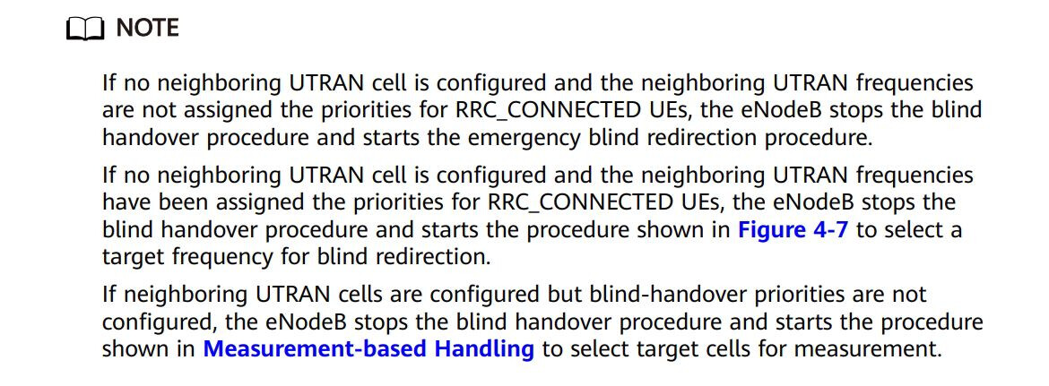

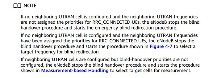

If the CSFB is through blind HO, then the neighbors are not important, only the UTRANNFREQ.
Maybe there are some missing frequencies or the priorities are not well set.

I thought blind delivery just bypassed the radio levels, but relationships (utranncell) still needed.

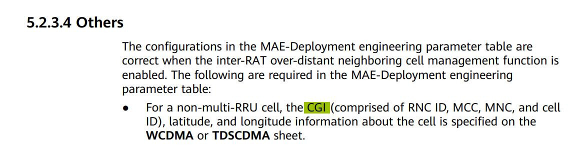

However, I got this from ANR documentation in Huawei, I think Huawei for ANR is able to request the rnc id from UE, and I am 100% sure that ANR is able to create UTRANEXTERNALCELLS which include the rncid.
Step4 read BCH… I am just curious in which IE / message / SYSINFO is the rncid.

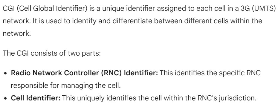

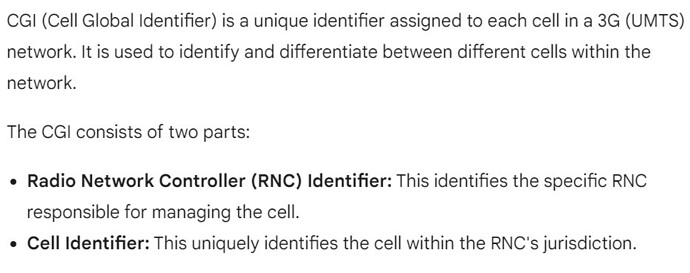

Maybe cellid = RNCID + cellid
But this depends on how operator define cell id.
I think it should be read somewhere, if I remember well, I test on time using Genex Probe without importing EPT to see what parameters the software was able to pick up and I think I was able to see the rnc id.
So it looks like CGI is based on rncid and cell id.
But I never heard of rncid to be sent to UE in any IE / message / SYSINFO.
So I am curious to know how UE knows the rncid of the 3G cell.

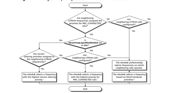

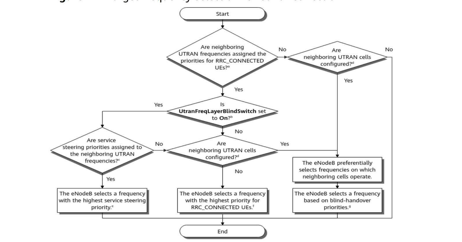

It can work both ways depending the configuration, look one the options you have in this flow.
