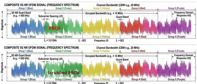

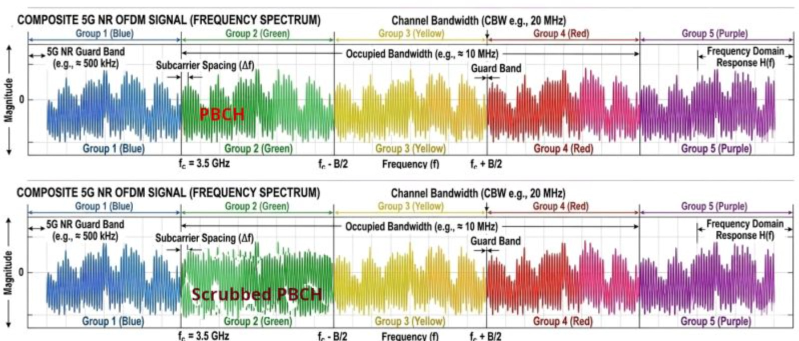

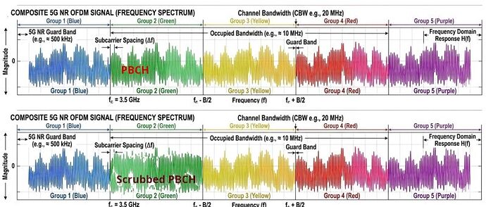

The attack targets the Physical Broadcast Channel (PBCH) to disrupt cell acquisition.
  • Cell Suppression: The attacker uses a USRP tuned to the carrier frequency of 3.5 GHz, transmitting specifically across a 7.2 MHz bandwidth (240 subcarriers PBCH).
  • Sync Loss: This targeted interference distorts the PBCH in specific subframes. As a result, the PBCH RSRP drops significantly below -118 dBm.
  • Cell Selection Failure: Legitimate UEs attempting to connect fail the S-Criterion check due to the low RSRP, preventing them from detecting or joining the cell. They are forced to hand over or connect to neighboring cells.
  • Packet Sniffing & Decryption: Existing users with active sessions do not experience immediate call drops, masking the attack. However, for dropped or target users, the attacker sniffs the RLC payloads. By running long-duration checksum analysis, the attacker can compromise security keys, de-authenticate SDAP packets, and decrypt user data.
During a live network log analysis , the following exposed the attack:
  • Network-Side Logs: Showed no unusual data drops, and active users maintained stable traffic without call drops.
  • UE-Side Logs: Exhibited highly anomalous behavior, failing cell selection despite a seemingly healthy macro environment.
  • Fronthaul (FH) Capture: A deep-dive Fronthaul packet capture revealed that the 240 subcarriers dedicated to the PBCH were heavily distorted only during specific subframes, confirming localized, deliberate interference rather than general path loss.

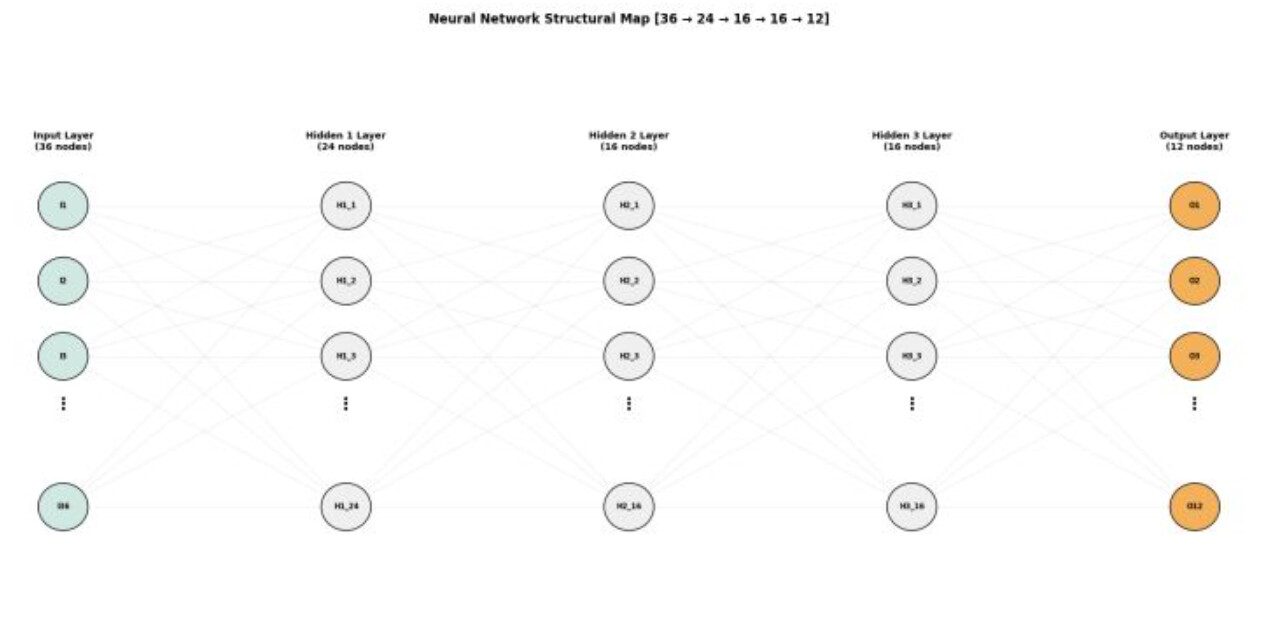

  • Uplink : To combat Uplink distortion (specifically targeting the PUCCH), a 3-Layer Neural Network was developed. It was trained on historical dataset formats for all PUCCH variations.
  • Downlink : The same neural network architecture was applied to the PBCH, utilizing previously stored Cell IDs from historical logs.

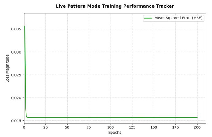

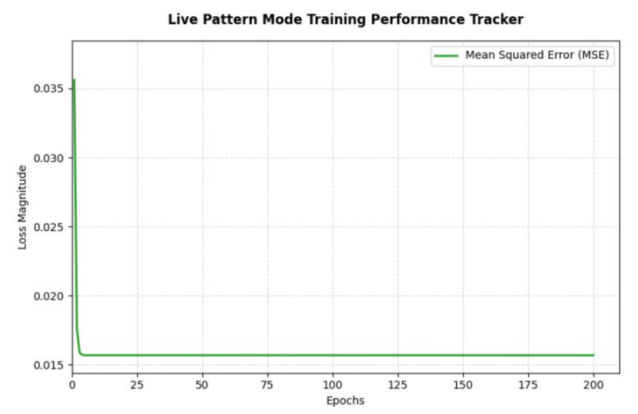

Results: Python simulations yielded highly successful results, allowing the UE to accurately decode the distorted PBCH and successfully attach to the network despite the presence of the USRP jammer. The solution is also designed to scale seamlessly for Massive MIMO environments.
The Algorithm took around 20 mins to train the network with previous data and was able to reach epoch in approximately 7.2ms which is sub-optimal.
