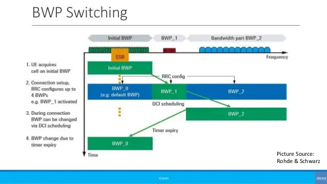

After the bwp-InactivityTimer expiry, which BWP is activated / switched?
Hello 5G NR PHY experts.
Normally, default bwp is also initial bwp.
After BWP inactivity timer , UE switch its active DL bandwidth part to a default DL bandwidth part

WP inactivity timer is seen as a backup mechanism for bwp switching through DCI.
Backup mechanism at UE to switch to default bwp after some time when it misses decoding the dci carrying bwp switch indicator.

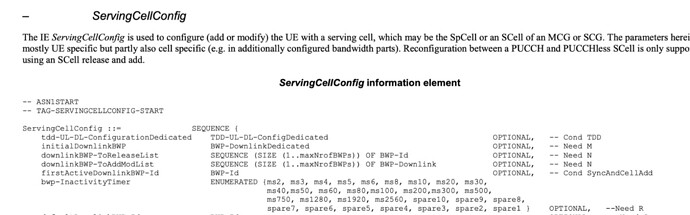

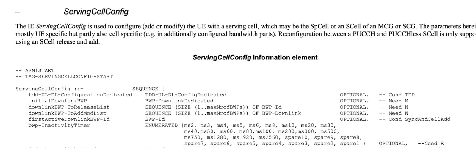

How is it configured to UE?
Isn’t it given from gNB to UE?
It is given in RRC reconfig.
I checked it, not able to see such timer…

BWP Inactivity timer facilitates UE to switch to default BWP if conigured, If not, it switches to InitialBWP. I always wonder, Is this BwpInactivitytimer is maintained by Network as well ? because if BWPInactivity timer gets expired, UE swtiches the BWP, If network doesn’t track this, How does network know UE has swtiched to the default BWP ?
