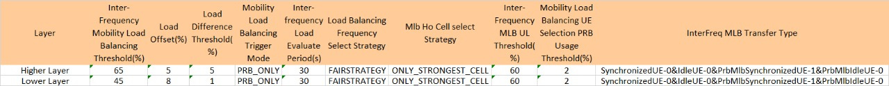

Using these settings for initial tuning and keeping InterFreqMlbSwitch OFF for L900.

What’s your prbloadcalcmethod? Should be prb_usage.
Also mlbtriggermode shoudl be prb_only.
Yes prbloadcalcmethod is prb_usage and mlbtriggermode is prb_only.

What you can do change InterfreqMLBthd from 65% to 50% for 1800 Layer (75 PRBs).
This way you will force MLB to work almost all the time.
