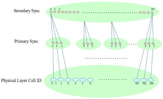

All eNBs generate PSS and SSS. Typically each eNB uses it’s own SSS, and each sector uses one of the three PSS. SSS and PSS are both sequences of values over time-frequency resources, repeated periodically. Sequences are known to UE in advance. UE correlates the known sequences with what it receives, and selects the one with the highest correlation. That is going to be the cell it will camp onto. After that the UE is able to receive MIBs and SIBs.

In LTE (within a carrier) all cells typically use same frequency. PSS and SSS are probably what you call the beacon signals. The sequencies are standardized, so the UE knows what sequencies to try for correlation. Please note that this doesn’t yet require any kind of decoding. When UE has determined the PSS and SSS sequencies giving the strongest correlations, it can calculate Cell ID. With cell Cell ID the UE knows where the Reference Symbols are located, and can receive and decode MIB and so on. MIB is the first “real” message to be decoded.
Yes your understanding is correct. When Power ON, Ue will search all the supported band EARFCN as per its capability and try to filter the list of EARFCN based on RSSI and sorted in ascending order of received RSSI. From the EARFCN Ue can easily calculate centre frequency. Since the time/frequency position of PSS/SSS is fixed by 3GPP(Centre 62 Sub carriers) ,Ue can read the PCI.Then Ue can read MIB in PBCH which was scrambled with PCI.Then Ue comes to know BW,SFN,Antenna config and PHICH.From PHICH,PDCCH config may be obtained.PDCCH will shows the placement of SIB in PDSCH.Then cell selection procedure will be started based on S criteria .(Note preferred PLMN Value list stored in SIM Card and also broadcasted in SIB1).

  1. During initial access, UE in DL always tuned at the center of bandwidth (because PSS/SSS are always transmitted by eNB at the center of bandwith/carrier)
  2. UE receives PSS (frame synch) and SSS (symbol synch) and based on that calculate PCI.
  3. UE receives PBCH cannel (based on PCI info) and decode main PBCH info. At this stage UE synchronized in DL direction. Now UE need to be synch in UL direction.
