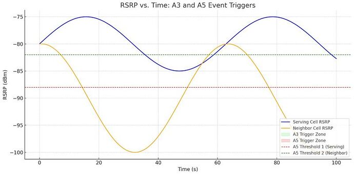

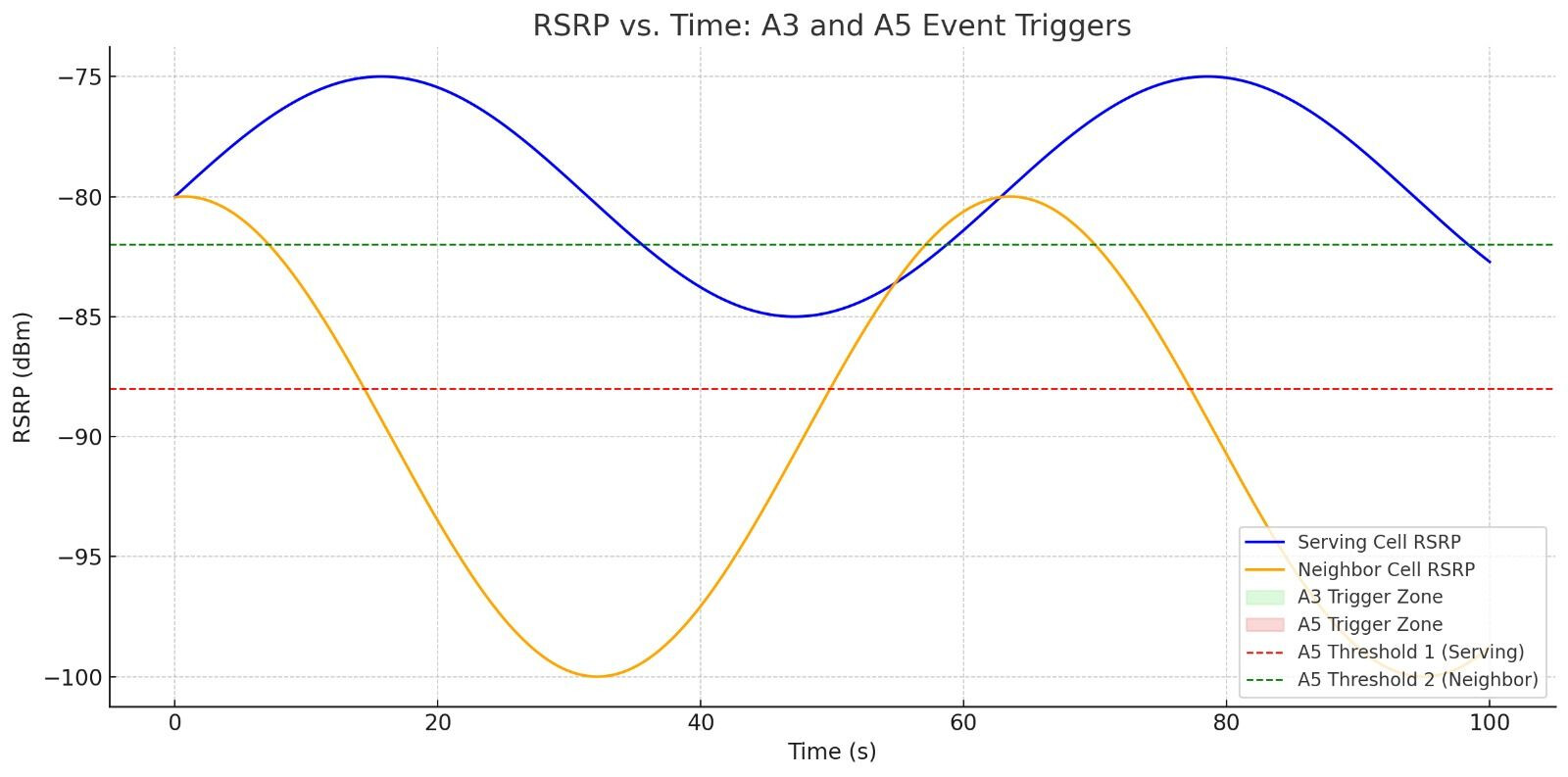

Graph Idea:
Here is the graph showing the RSRP (Reference Signal Received Power) of the serving and neighbor cells over time, including the A3 and A5 event trigger zones:
A3 Trigger Zone (green): Neighbor cell becomes stronger than the serving cell by an offset (3 dB).
A5 Trigger Zone (red): Serving RSRP drops below Threshold 1 (−88 dBm) and Neighbor RSRP exceeds Threshold 2 (−82 dBm).
