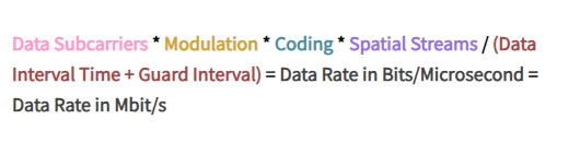

The numbers are not random at all – the data rates of OFDM PHYs (802.11a, 802.11g, 802.11n, 802.11ac) are all based on the same single formula, which consists of 5 variables:
- Data Subcarriers (number of subcarriers that transmit modulated data)
- Modulation (amount of bits each data subcarrier can represent; predefined mix and match possibilities with coding)
- Coding (defines how much of the modulated data is useful data and how much of it is for error correction; predefined mix and match possibilities with modulation)
- Spatial Streams (number of unique MIMO data streams that can be sent in parallel)
- Symbol Interval Time (the sum of Data Interval Time + Guard Interval)
I’d like keep this blogpost short and sexy, and just show how you can calculate the different data rates based on these numbers.
