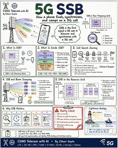

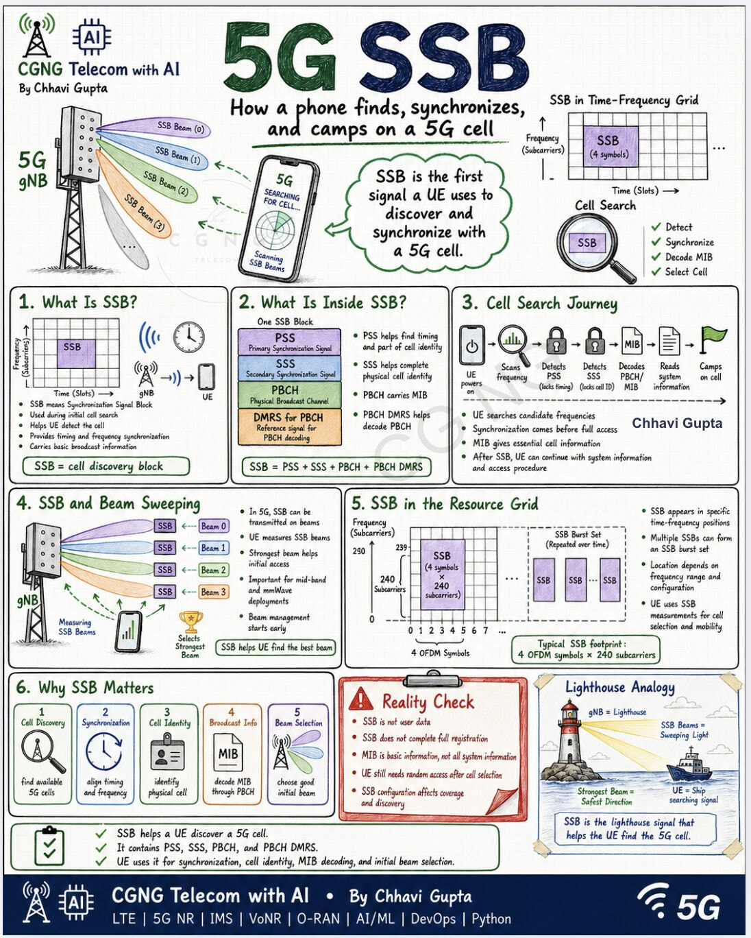

5g ssb
SSB is one of the first signals a phone uses to discover a 5G cell.
Before a UE can register, attach, access data or use services, it must first find and synchronize with the cell.
That journey starts with SSB.
SSB means Synchronization Signal Block.
It helps the UE:
Detect the cell
Synchronize in time and frequency
Identify the physical cell
Decode basic broadcast information
Select an initial beam
  1. What is SSB?
SSB is used during initial cell search.
It helps the UE detect the 5G cell and synchronize with it.
Simple memory:
SSB = cell discovery block
  1. What is inside SSB?
An SSB contains:
PSS
Primary Synchronization Signal
SSS
Secondary Synchronization Signal
PBCH
Physical Broadcast Channel
PBCH DMRS
Reference signal for PBCH decoding
Simple formula:
SSB = PSS + SSS + PBCH + PBCH DMRS
  1. Cell search journey
The UE goes through this basic journey:
Power on
Scan candidate frequencies
Detect PSS
Detect SSS
Decode PBCH / MIB
Read basic system information
Camp on the cell
Synchronization happens before full access.
MIB gives essential cell information.
After SSB, the UE can continue with system information and access procedure.
  1. SSB and beam sweeping
In 5G, SSB can be transmitted on beams.
The UE measures different SSB beams.
The strongest beam helps initial access.
This is very important for mid-band and mmWave deployments.
Simple memory:
SSB helps UE find the best beam.
  1. SSB in the resource grid
SSB appears in specific time-frequency positions.
A typical SSB footprint is:
4 OFDM symbols
240 subcarriers
Multiple SSBs can form an SSB burst set.
The UE uses SSB measurements for cell selection and mobility.
  1. Why SSB matters
SSB is important for:
Cell discovery
Synchronization
Cell identity
Broadcast information
Beam selection
Without SSB, the UE cannot properly find and synchronize with the 5G cell.
  1. Reality check
SSB is not user data.
SSB does not complete full registration.
MIB is basic information, not all system information.
The UE still needs random access after cell selection.
SSB configuration affects coverage and discovery.
  1. Lighthouse analogy
Think of the gNB like a lighthouse.
SSB beams are sweeping lights.
The UE is like a ship searching for signal.
The strongest beam helps the UE find the safest direction toward the cell.
  1. Quick takeaway
SSB helps a UE discover a 5G cell.
It contains PSS, SSS, PBCH and PBCH DMRS.
The UE uses SSB for synchronization, cell identity, MIB decoding and initial beam selection.
