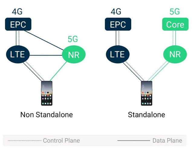

  • 5G SA (Standalone) uses a 5G RAN and a cloud-native 5G core.
  • 5G NSA (Non-standalone) uses a combination of existing 4G LTE architecture with a 5G RAN. (Creates a 5G network with 4G infrastructure using dual connectivity).

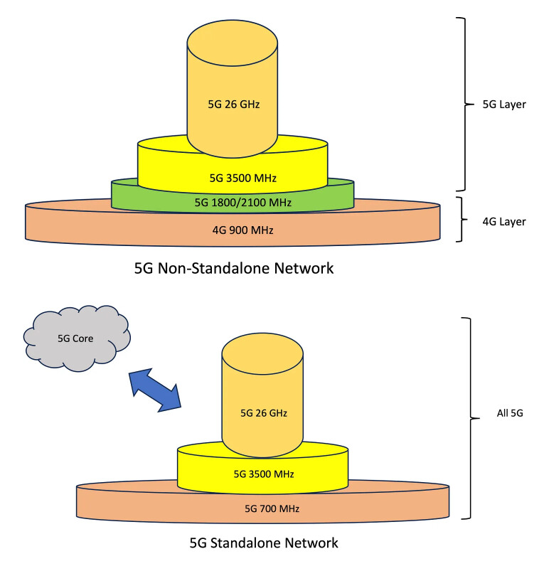

𝐖𝐡𝐚𝐭 𝐢𝐬 𝐝𝐢𝐟𝐟𝐞𝐫𝐞𝐧𝐜𝐞 𝐛𝐞𝐭𝐰𝐞𝐞𝐧 𝐍𝐒𝐀 𝐚𝐧𝐝 𝐒𝐀 𝟓𝐆?
  • 𝐍𝐒𝐀 (Non-Standalone Access) and 𝐒𝐀 (Standalone Access) are Two 5G network modes.
  • 𝟓𝐆 𝐍𝐒𝐀 depend on the 𝟒𝐆 Network to provide More speed and Higher data bandwidth.
  • 𝐒𝐀 is the true 𝟓𝐆 network with dedicated 𝟓𝐆 Core to provide super speed improvements (𝟏𝟎𝐆𝐛𝐩𝐬) and lower Network latency (delay around 𝟏𝐦𝐬) .
  • The 𝟓𝐆 SA network is independent of the 𝟒𝐆 network.
𝐖𝐡𝐚𝐭 𝐚𝐫𝐞 𝐭𝐡𝐞 𝐚𝐝𝐯𝐚𝐧𝐭𝐚𝐠𝐞𝐬 𝐨𝐟 𝟓𝐆 𝐍𝐒𝐀 𝐚𝐧𝐝 𝐒𝐀 𝐧𝐞𝐭𝐰𝐨𝐫𝐤𝐬?
  • 𝐍𝐒𝐀 makes it easier for network operators to deploy a 𝟓𝐆 network as it can reuse the current 𝟒𝐆 facilities.
  • 𝐒𝐀 has a 𝟓𝐆 core which can deliver a super-fast and flexible network, ultra-low latency, and then reducing operational costs.
