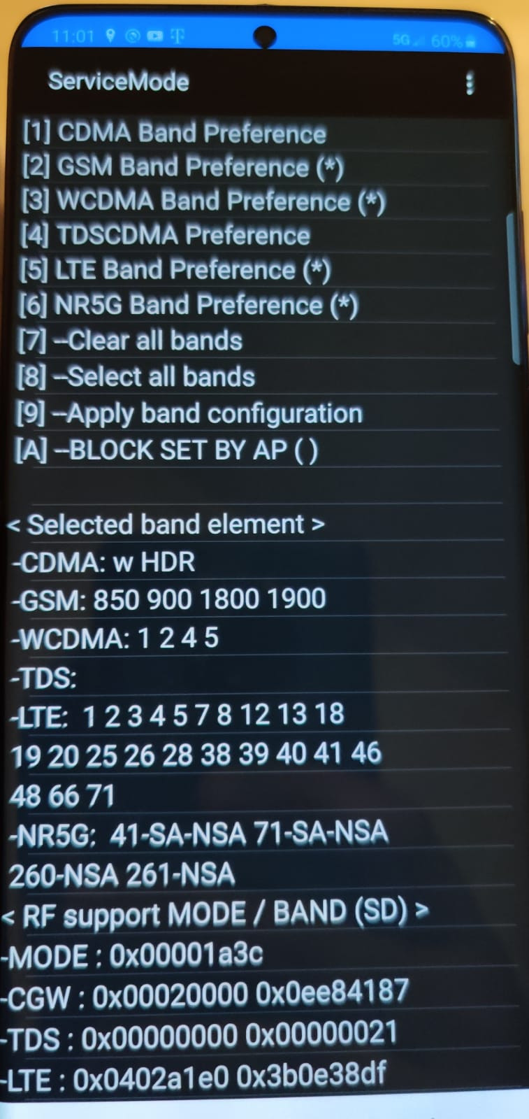

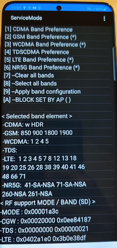

Try *#2263# and you can check if the device support SA or not.
Something like this, it says NR5G SA-NSA support:
Yes, the device support SA -NSA.
