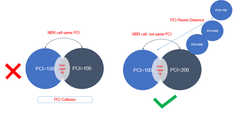

Rule #1 Usage of same pci
Since we have 504 PCIs so this rule is usually not difficult to follow.
The same site should not use the same PCI again on the same frequency
The NBRs of the site should not have the same PCI on the same frequency
Ideally, two NBRs of the site should not have same PCI between them. For instance, Cell-A has NBR Cell-B and Cell-C and both of them have the same frequency, then the PCI of Cell-B and Cell-C should not be identical. This is difficult to maintain in a LTE network but this issue can cause PCI confusion and handover failures
