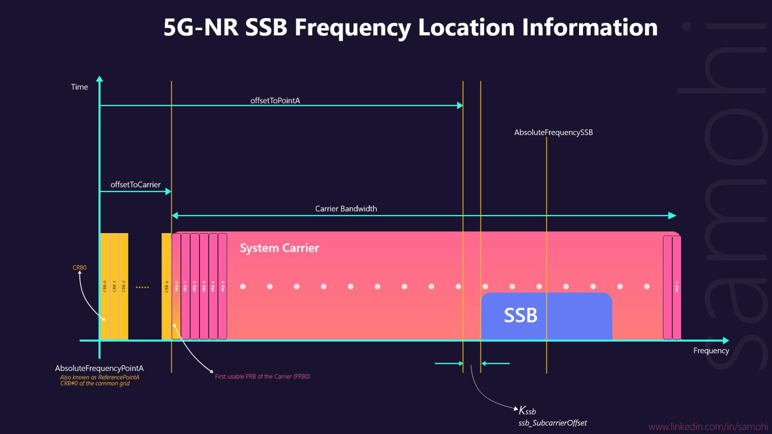

I’m having confusion on reference point A in 5G NR SA. is it mip location?
How do we choose that reference point A according to what?
What is the implicitly meaning of it?
I just to understand the idea of it because in lte we dont have A reference point.
I’m asking about reference point A because all offsets like CORESET offset and other offsets are referenced to that point.
5G-NR SSB Frequency Location Information
I made a post about this a while back on Linkedin, do check it out. It gives a visual representation for easier understanding.
Let me know if you have any questions:
This NR-EARCFN that appears into Samsung Field Test is SSB, Freq.PointA?
Do you have any 5G NR ARFCN Calculator in Excel?
This is the SSB position.
3511.2 MHz
Yes.
Based only on ArfcnDL (636667) is possible to know the PointA and SBB ARFCN?
I don’t think so.
But one intedirect way might be to check if it’s valid GSCN value.
No it’s not possible.
To calculate the Point A, you need GSCN, Kssb and Offset to PontA.
