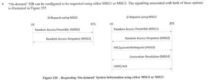

a) UE will trigger CBRA RACH procedure, MSG1 and MSG2 are same as regular RACH.
b) In MSG3 UE will send SI-Request which is included in RRC System Info Request Message. There is an IE requested-SIList which allows UE to request all SIBs or specific SIBs.
c) As a response of MSG3 , network will send other requested system information.

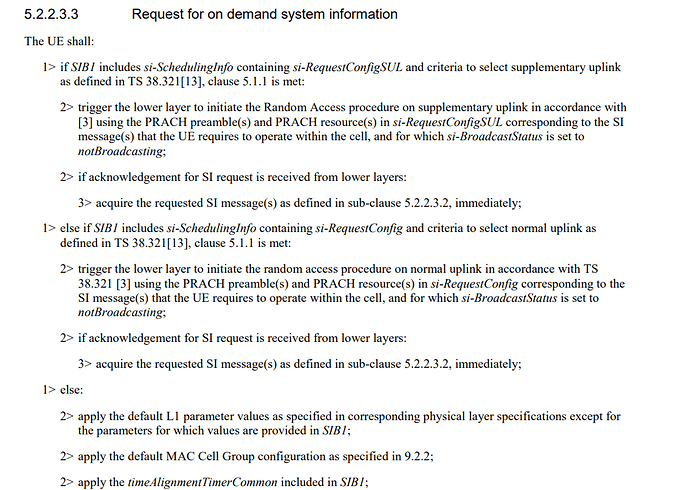

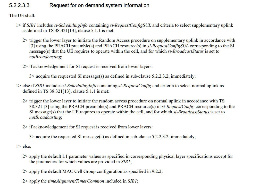

You can refer to 3GPP TS 38.331 5.2.2.3.3. For a simpler understanding you can also refer to 5G NR in Bullet Section 06 (Pg.265) and find more details.

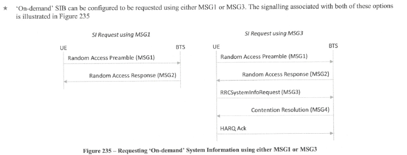

Quick reference from 5G NR bullet book.
