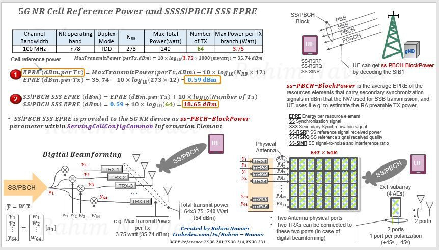

5G Base Station determines the downlink transmit EPRE (Energy Per Resource Element).
For the Secondary Synchronization Signal (SSS), the downlink SS/PBCH SSS EPRE can be derived from the SS/PBCH downlink transmit power and is provided by ss-PBCH-BlockPower parameter (as higher layer parameter) to the 5G device.
ππβπ·π©πͺπ―βπ©πππππ·ππππ is the average EPRE of the resources elements that carry secondary synchronization signals in dBm that the NW used for SSB transmission, and UE uses it e.g. to estimate the RA preamble TX power.
The downlink CSI-RS EPRE can be derived from the SS/PBCH block downlink transmit power given by the parameter ππβπ·π©πͺπ―β π©πππππ·ππππ and CSI-RS power offset given by the parameter π·πππππͺπππrπππΆππππππΊπΊ provided by higher layers.
Here I try to depict how EPRE(dBm, per Tx branch) is calculated as the cell reference power. The πΊπΊ/π·π©πͺπ― πΊπΊπΊ π¬π·πΉπ¬(ππβπ·π©πͺπ―β π©πππππ·ππππ) is then calculated using the cell reference power.
