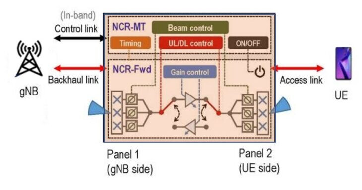

We know RF repeaters are cost-effective for expanding network coverage, but they are limited in terms of accommodating factors that enhance network performance and efficiency, like dynamic DL/UL configurations, adaptive spatial beamforming, and ON-OFF stages. To overcome these limitations, 3GPP initiated a new Study Item in May 2022 focusing on Network Controlled Repeaters (NCRs).
NCRs carry forward the legacy amplify and forward operation of RF repeaters, but also receive control information from the 5G gNB to function more efficiently. Using this control information, NCRs enable transmissions and receptions with improved spatial directivity, enable easy network integration, and minimize unwanted interference.
