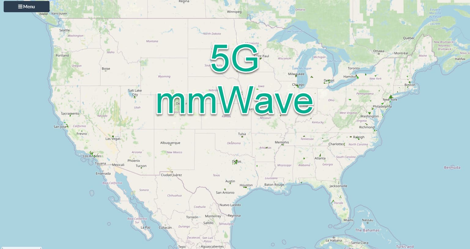

Apart from Verizon in US, do you know other MNOs that have deployed commercially 5G in mmWave on a large scale?
I mean tens of thousands of cells, not just few tens of cells in downtown…
Verizon deployed it in major cities in US → Cellular Tower and Signal Map

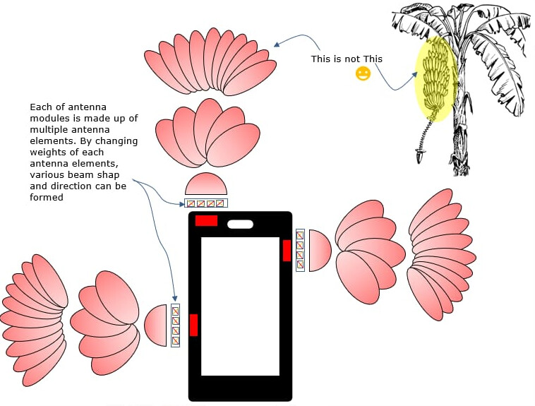

I’m not very sure, but I think FR2 antennas at the UE are directional.
I am just thinking how this would be possible.
You keep the UE on the table, you never know in which direction is the gNodeB.
Omni antenna will accommodate this scenario, directional antenna will fail to accommodate this.
Maybe someone can confirm if UE transmission antenna is directional or not.
To my understanding it is omni.
Antenna gain can be very different between UE and gNB, for example directional antennas at the gNB can have a gain of 20 dBi, (less or more depending on the array configuration).
However UE antenna gain can be 3 dBi for example (less or more depending on the configuration).

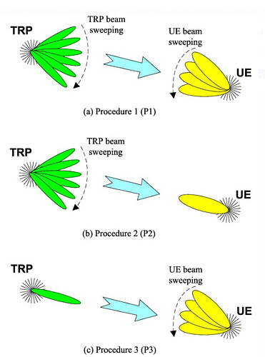

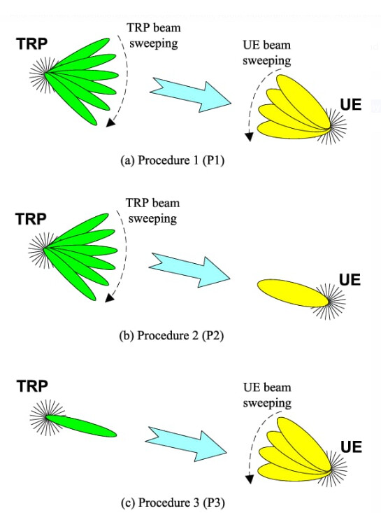

You can perform beam sweeping in the Uplink to catch a Downlink beam I will show a photo to illustrate how:
I think that is for reception, I am aware that this is possible.
The whole process is called beam management.
Assuming your UE wants to access the network it has to catch SSB beam, and since UE antennas are directional UE will perform beam sweeping to find the best SSB.
But again that is for Downlink.
I am speaking about Uplink.
Beam sweeping of the UE can be done for Downlink. I agree with this.
Yeah, I know. I’m also talking about Uplink, after gNB and UE establish a beam pair (suitable Uplink beam with suitable Downlink beam) they can communicate.
In both directions (Downlink and Uplink).
To have beam sweeping in Uplink you need to shift the phase of several TX antenna in the UE.
And currently are just 2 of them.
Even if you put 4 or 8 they still need to be omni. If directional, then gnodeB may be out of the main lobe of the UE directional antenna tranmission.
