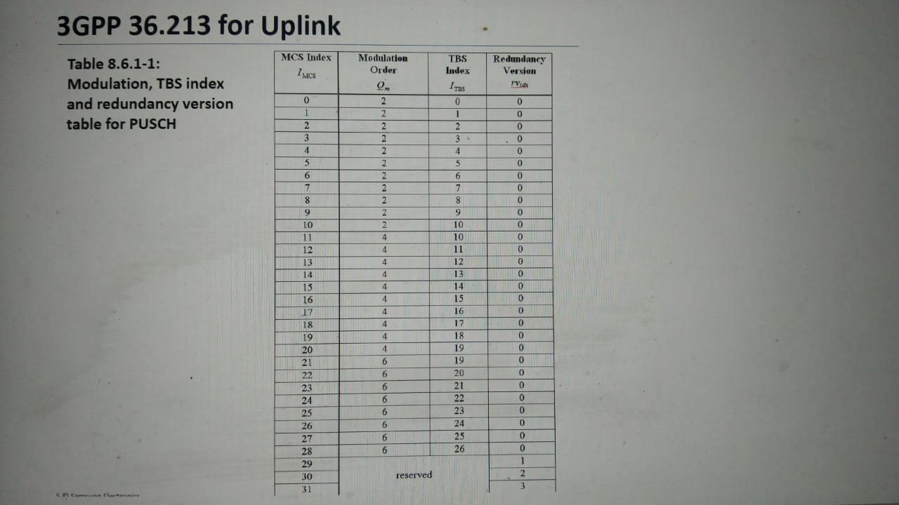

Can you show 3gpp table of MCS UL 64 QAM?
I remember it just says MCS UL same as DL.
That is what I also remember.
I found the reason: for 256 QAM is same table for PDSCH and PUSCH!

Does mcs → tbs table will change?
Yes, for NR is different for UL and DL for 64 QAM.
Bt for 256 QAM UL and DL NR is the same.
Yes, corrrect.
But I didn’t knew that till reading 38.213.
I was looking for PUSCH 256 QAM table and it was not there…
It’s same, that’s why.
