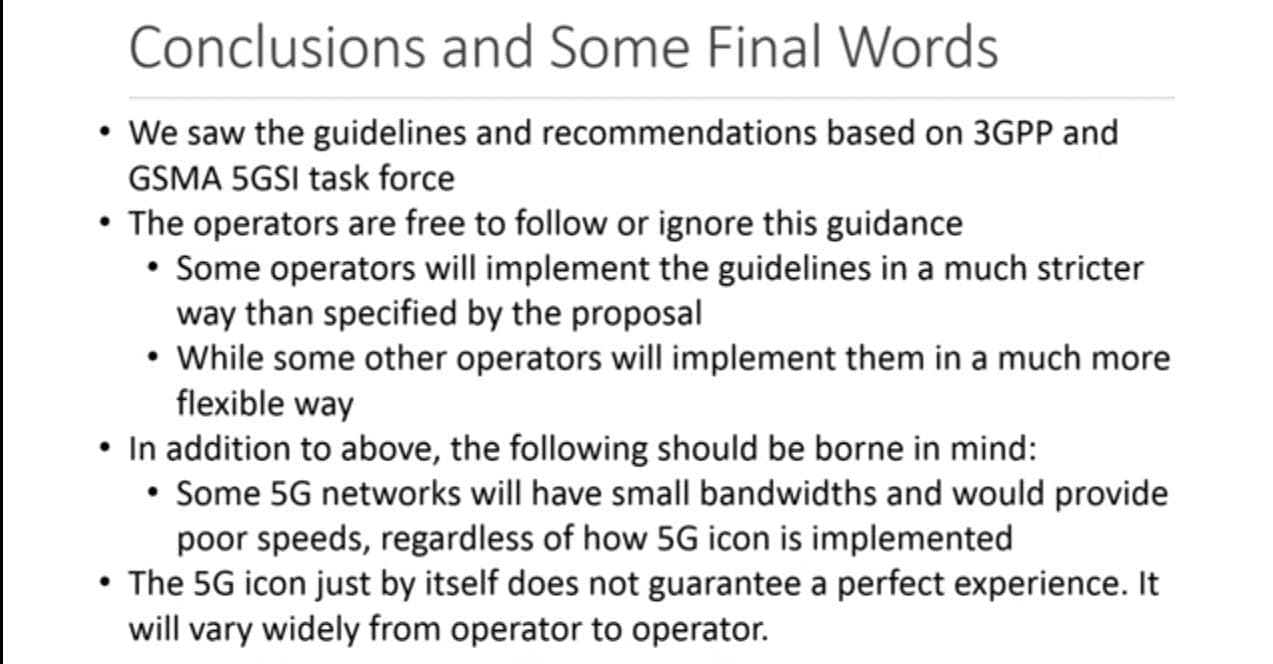

As others said, whether UE shows 5G icon in presence of upperlayer indication or not depends on the mobile operator choice and the used config for 5G icon visibility.
I guess it has nothing to do with the handset.

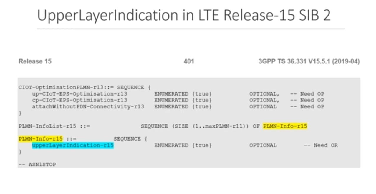

Did you see upperLayerIndication-r15 true on lte sib2 ? if yes, showing 5g icon in case really connected to 5G depends on device decision on profiles.
If you dont see 5G icon at all in Samsung that means your sgnb addition was failed, in my opinion.

I beleive its controled by the mobile operator and not the device manufacturer.
If you have 2 UEs from difeerent manufacturers under the same network showing different icons then you can claim its comtroled by the UE.

As I mentioned if it depends on the handset, we should have differnet UEs showing different icons. Have you ever seen such a thing?
Under same environment.
Same site, same location, same radio condition.
upperlayer indicatiom in sib2 is just let handset to know 4G cell has a connected 5G cell nearby so there is 5g coverage “expected”.
So it is %100 depends on handset to show off 5G icon in case it is really connected to 5G leg and transfer data or even it is not connected to 5g leg some phone can show 5G icon, this is profile above somebody posted.
Only part I am not aware that how to check handset profile.

Network just sends the 1 bit information.
It can not control UE decision.
