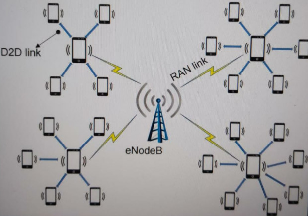

I was in meeting yesterday with NCSU (New York City State University) discussing some 5G uses cases.
They achieved 65 ms D2D communication using LTE eNdeB.
And drone are colliding to each other.
5G goal is to achieve around 1 ms latency using intel updated GPU and research from NCSU in cooperation with AERPAW with US PAWR and our SAS solution.
