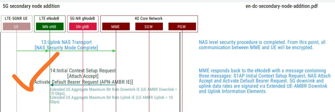

Why UE will not get 5G services according to this call flow: https://www.eventhelix.com/5G/non-standalone-access-en-dc/en-dc-secondary-node-addition.pdf ?

It is attach accept that informs if dc will be used or not.
Dc will restricted as per the case.
