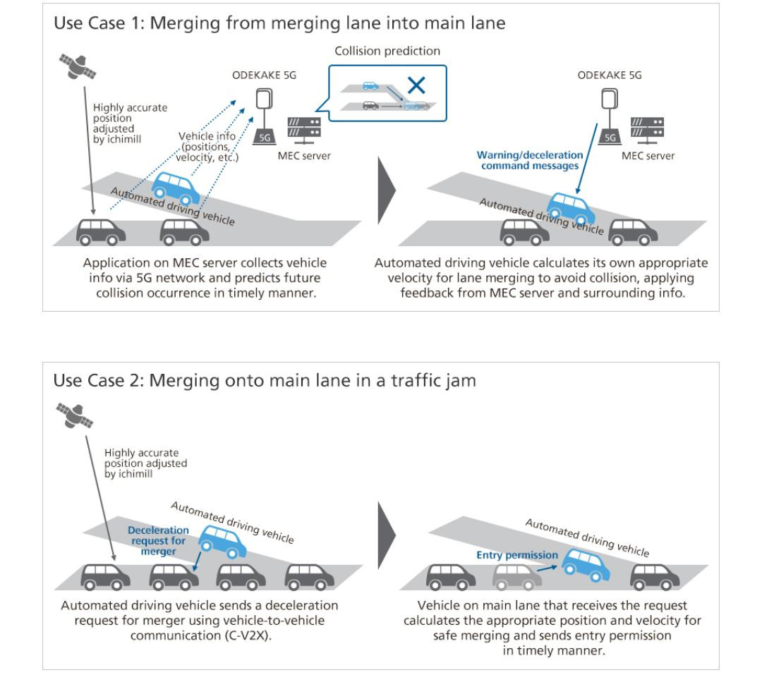

Yes, so the technical gap is to pass that info to other vehicle via V2V or Sidelink, which i dont think is too much big technical leap and can be achieved.

The Range of v2v communication is of around 700-1000 mts and the fading conditions are taken care already by the standard in such a way that v2v works seemlessly
The cars would communicate at 100ms which is good enough to have the V2V applications working
