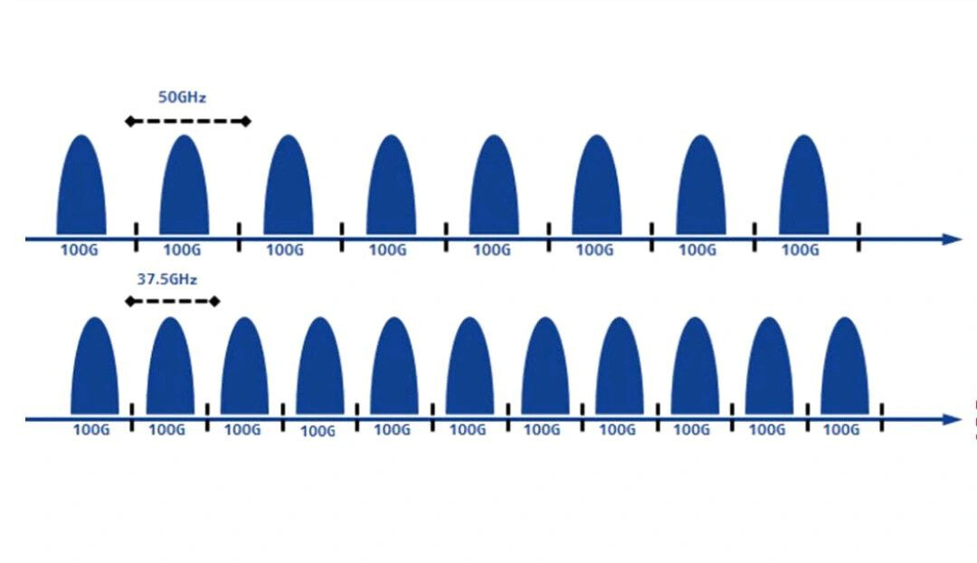

How flexGrid affect the spectrul efficiency ?
By fitting more channels in the same bandwidth, it allows finer granularities of optical channels 37.5 , 25 , 12.5 , 6.25 GHz, that would enhance the throughout by 33%
