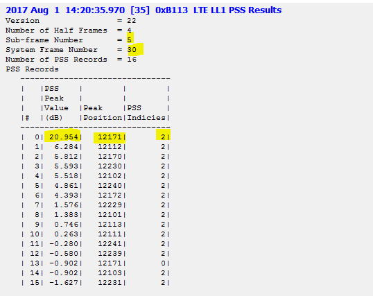

4G LTE Important QXDM Log Packets
QXDM is most widely used tool in wireless 4G,5G technology to capture Qualcomm based Mobile signalling and data details logs for debugging purpose. Whether it is Field testing or Lab testing, initial product development or carrier acceptance QXDM is most accepted tool.
In this post, we tried to put some of very import Logs packets information to help Wireless Test Engineers, how they can make best use of QXDM to debug any issue.
