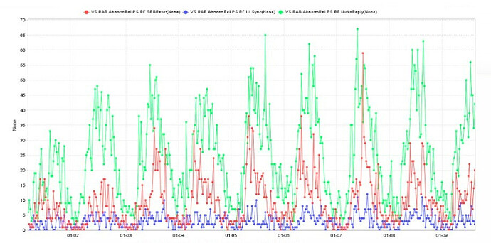

In review of PSCALLDROP 3G Huawei, I found the following counters:
The fail condition is Radio link Failure and these 3 causes
