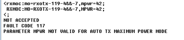

Hello Ericsson Experts. I used this command to reset power on 4 TX in WinFIOL. I got this error, “NOT ACCEPTED
FAULT CODE 117
PARAMETER MPWR NOT VALID FOR AUTO TX MAXIMUM POWER MODE”
Screenshot 2024-08-18 161802
Hi, @Dalton, you have the power (TXMPWR) set to AUTO on the MCTR like here:
MO                MAXPWR   MAXTRX   PAO   TXMPWR   IPM  MIXEDMODE  TPO
RXOMCTR-1-5       43.0      1       OFF   AUTO     OFF  OFF        OFF
MCTR’s MAXPWR is divided to MAXTRX automatically. So you don’t need to set it on TX, just skip this parameter.
Thanks. Instead of changing the TX power, I changed the MCTR MAXPWR.
