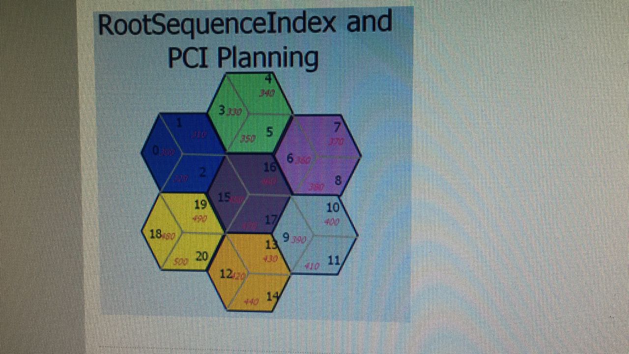

PCI Planning should be correct.
Can you share any tool to calculate PCI?..Rf planning tool
For Pci Planning,
You can perform Manually if you have low number of enodeb.
Or ATOLL from forsk or UNET from huawei tool are available…
You can also perform Frequency and Root Sequence planning.
You can plan one cluster with 20mhz and one cluster with 10Mhz.
If you found any Capacity issues on 10Mhz enodeb/cells, you can increase to 20Mhz.
