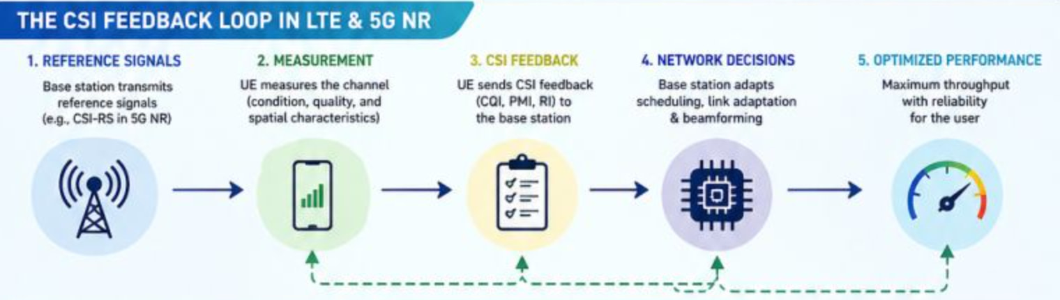

CSI tells the network how the radio channel between the base station and the device is behaving at any given moment — signal strength, interference, multipath fading, and spatial characteristics. Think of it as the network constantly asking, “How clear is the path right now?” and adjusting on the fly.
In LTE and 5G NR, this feedback loop typically includes:
→ CQI (Channel Quality Indicator) — how good is the channel, and what modulation/coding scheme can it support?
→ PMI (Precoding Matrix Indicator) — which precoding vector best shapes the signal for this channel?
→ RI (Rank Indicator) — how many spatial layers can be reliably transmitted (MIMO)?
Together, these feed into link adaptation and beamforming decisions, letting the network squeeze out maximum throughput without sacrificing reliability.

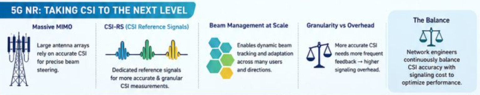

With 5G NR’s Massive MIMO and CSI-RS (CSI Reference Signals), this has become even more granular — enabling beam management at scale across dense antenna arrays. The tradeoff? More accurate CSI generally means more overhead and reporting frequency, so network engineers are always balancing feedback granularity against signaling cost.
From a KPI monitoring standpoint, tracking CSI-related metrics (CQI distribution, RI utilization, PMI feedback rates) offers early signals of degrading coverage or capacity bottlenecks — often before end-user complaints even start rolling in.
