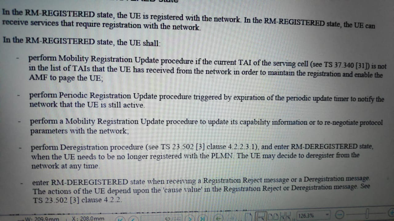

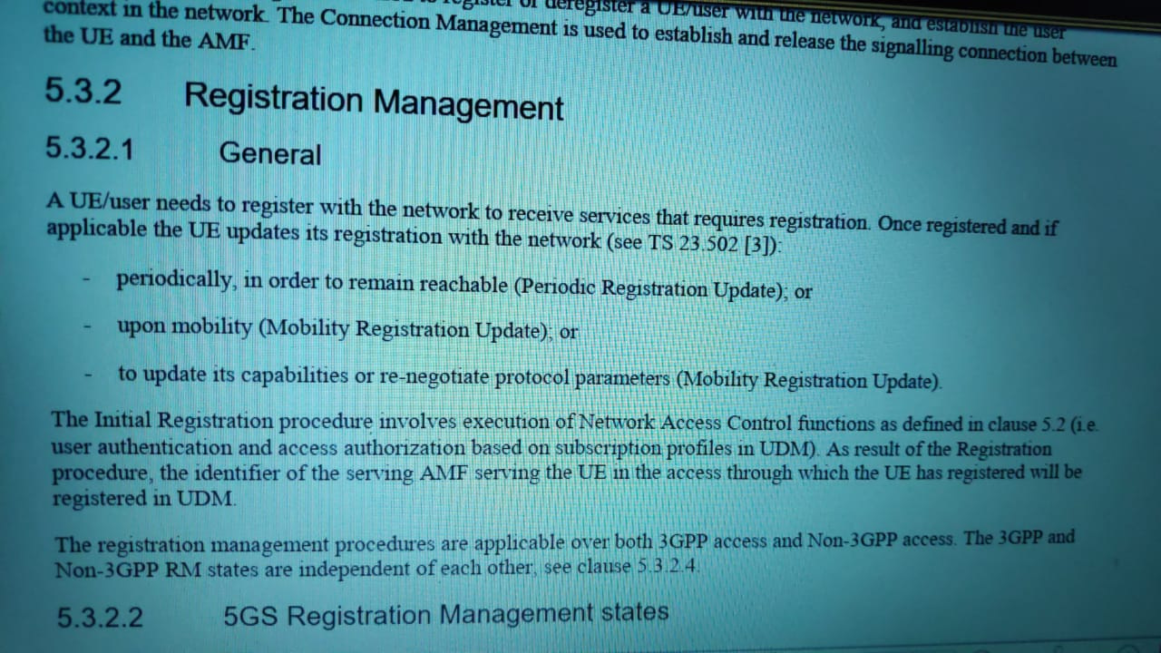

Point 3… Even to update UE caps it will do MRU:
Point 1 confirms what you said:
Attached CR has all possible reasons mentioned.
Please look for ‘24501_CR0683_(Rel-15)_C1-188410’

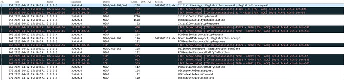

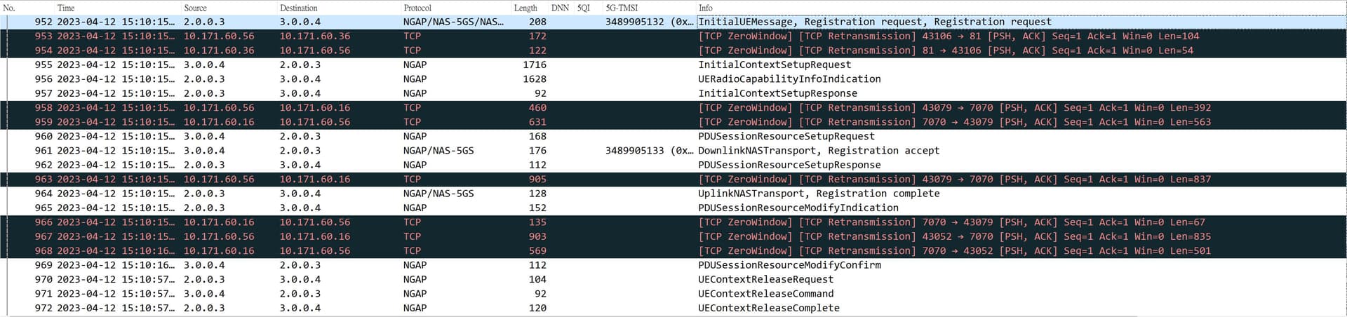

in my case,UE trigger registration request with cause “mobilty registration update”,its try create NRDC,log will show registration request with “mobility reggistration updating” and registration accept & complete ,than follow log is PDUSessionresourcesetupresponse and PDUSessionresourcemodifyconfirm ,will see transportlayeraddress changed.
1、When UE moves to a new tracking area (TA, Tracking Area) outside the registration area;
2、UE needs to update the negotiation capability or protocol parameters during the registration proces;
3、When UE wants to obtain LADN (Local Area Data Network) information。
