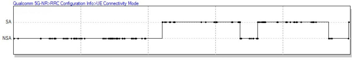

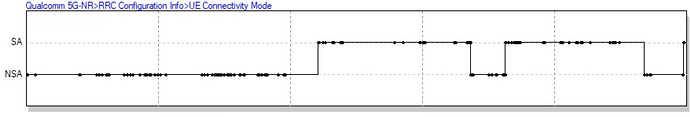

Another doubt in same subject here:
What can be the network setting which allows the phone to use SA only when NSA anchored LTE goes below an RSRP threshold and when LTE anchor goes above the thrshold the UE uses NSA?
Also: second observation is that my SA-NSA capable device goes to SA only when I do Airplane mode on off and reinitiate attach, else it stays in LTE only without even attempting NSA SCG addition. How to check what is the cell search priority?
Check sib 24 in lte: there you will find 5G NR priorities and subpriorities.
For SA, I mean.
I couldn’t get SIBs in LTE. After 30s in LTE airplane mode test started and went to SA.
Have asked for a longer test in LTE tmrw.
If no sib24 broadcasted, then no reselection from 4G to 5G SA.
But I know the fact that when LTE cov is below some RSRP threshold then SA is allowed.
Have you noticed any handover/reselection between SA and NSA in logs at low RSRP?
We are trying to get something like this:
There should be IRAT handover.
