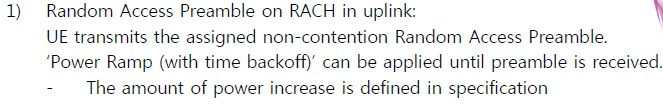

What if MSG1 itself is not responded by NW?
In that case, for how long UE should retry MSG1 with increased powerlevels every time?
This duration is given by T300.

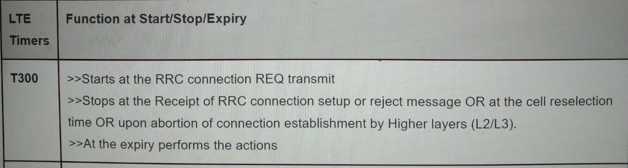

T300 is RRC timer and starts once the RRC layer generates the RRC request and sends it to lower layers.
Are you saying that T300 starts from RACH request (MSG1)?
Yes, that’s my understanding.

T300 defines the waiting time for the RRC Connection Setup message after transmitting the RRC Connection Request message, i.e. it corresponds to the waiting time for MSG4 after transmitting MSG3.

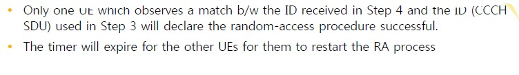

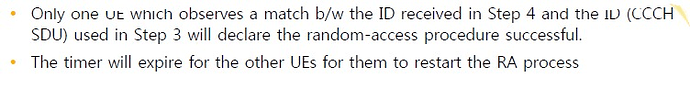

Contention resolution timer is to check if the eNB has sent the Contention Resolution Identity MAC CE in response to msg3 to complete the contention resolution procedure (for contention based mechanism).
If no such message from eNB during this timer, then the new RACH procedure happened.

When the macContentionResolutionTimer is expire then tow think happened.
⦁ Discard the Temporary C-RNTI
⦁ Consider the Contention Resolution not successful.
Once Msg3 is transmitted, the MAC entity will start mac-ContentionResolutionTimer and restart mac-ContentionResolutionTimer at each HARQ retransmission.
Monitor the PDCCH until mac-ContentionResolutionTimer expires or is stopped.
If the MAC PDU is successfully decoded then mac-ContentionResolutionTimer stop.
