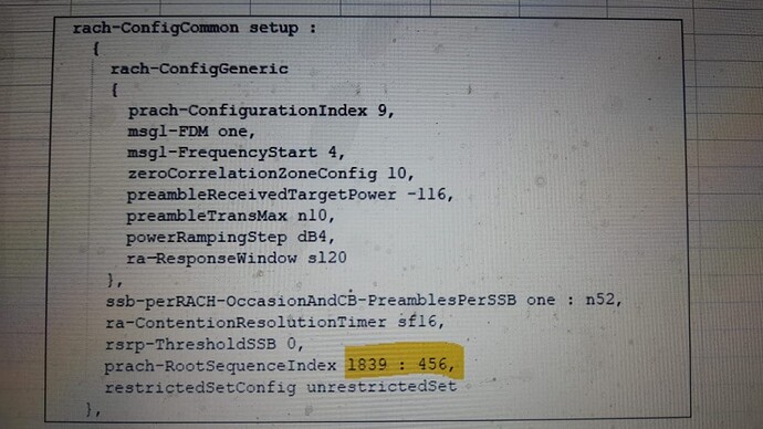

From SIB1 we have zeroCorrelationZoneConfig=10 => gives cycle shift 76 and root sequence per logical root sequence =11 and 6 root sequence per cell.
From prach-RootSequenceIndex l839 : 456=> logical root sequence is 456 which points toward physical root sequence 230,609,232,607,266,577

Can you also send SIB1 parameters related to RACH?
Shared RACH parameters above.
Just after this UE does reselection to different cell and completed RACH and made RRC.
SIB1 RACH parameters: :point_down:
Can you increase the preambleReceivedTargetPower from -116 to say -106 or -96 and try once.
At gNB side -116 seems very low.
