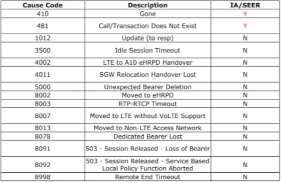

I’m experiencing VoLTE drop calls, and the SIP code is 8003, even though the radio conditions are excellent.
Any idea what could be causing this?

8003 as SIP Reason code?
Yes, correct.
But it is out of SIP standard.
I don’t know what this is, but SIP responses are defined under rfc 3261.
https://www.rfc-editor.org/rfc/rfc3261.html
Based on this explanation, it seems that voice packets (RTP/RTCP) are not transmitted for a certain period.

Then the issue might be related to RTCP.
One of the clients may not support RTCP.

The SBC should have a configuration setting for this.

This fact
Support this thesis
It means there haven’t been any downlink RTP packets for the last 20 seconds.
