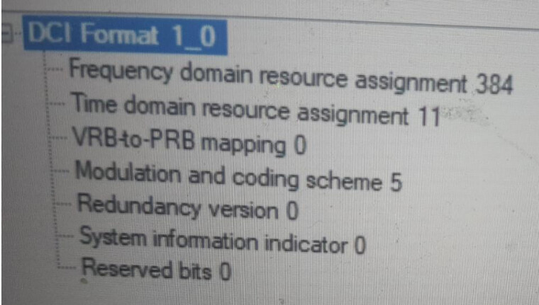

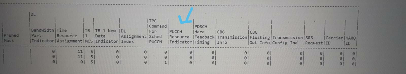

What is your PDSCH-to-HARQ_feedback timing indicator in msg 4?
I don’t think this is the complete dci info!
It doesn’t even have the harq id.
Are you sure this is the one for msg4 and not msg2?
Which tool your using yo read these?

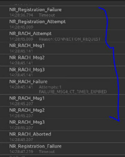

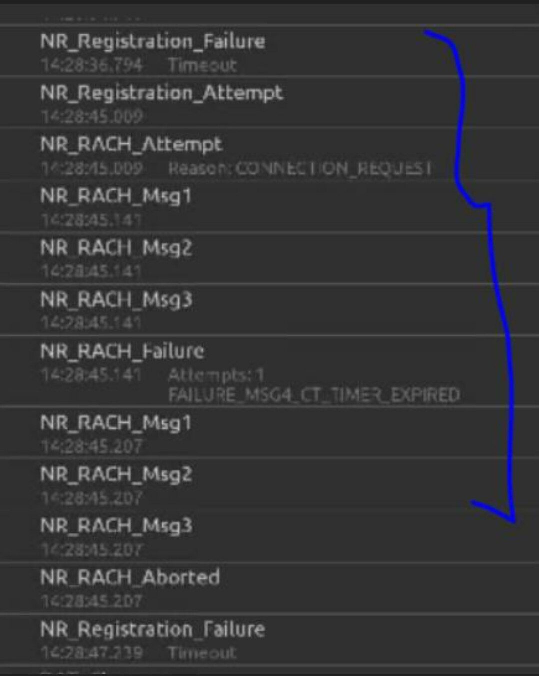

In UE log I don’t see rar message as well, just sib1 and msg1 sent to du.
The minute I change S slot to be configured for 2 UL symbol then UE attached, so weird.

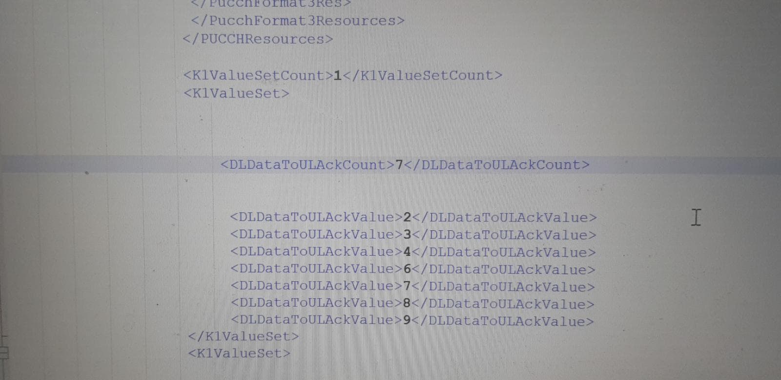

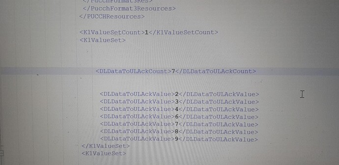

So how to prevent that the ack to be on S slot? To remove the slot 4 from k1 values?
In other words the DU tells the UE where to send ack, so which parameters tells the UE where to send ack?
The DU must send it but which params responseable for ack alots?
K1 values I think.

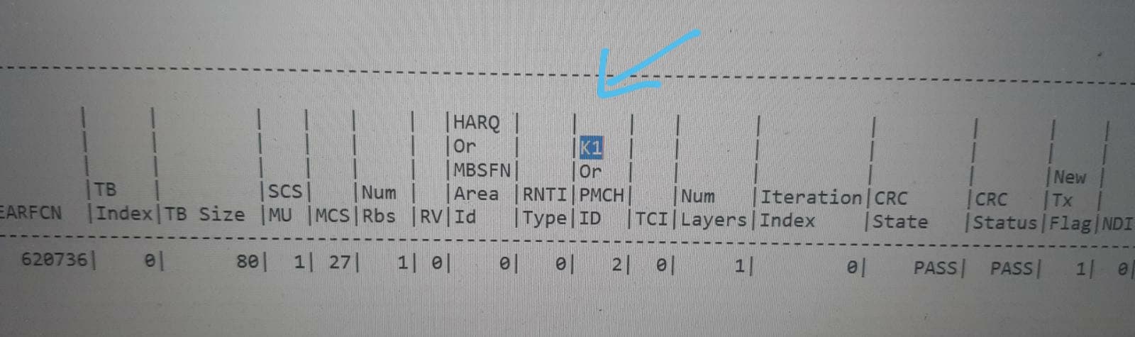

Also what I think is that UE send ack on S slot, so my confusion what param tells the UE to send ack on S slot?
UE also has in DDDSU. Th UL slots which is full UL symbols so there can send PUCCH info.
Real UE.
K1 index in DCI 1_0, which points to a predefined list of k1 values.
Yes.

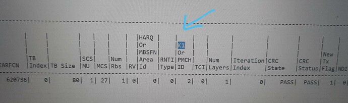

And just to add: this is qxdm log. It’s not an index here, but the absolute value!
Pdsch harq timing indicator, that’s the index.
I would recommend really going through the above ShareTech Notes i have shared above!
It will help!
