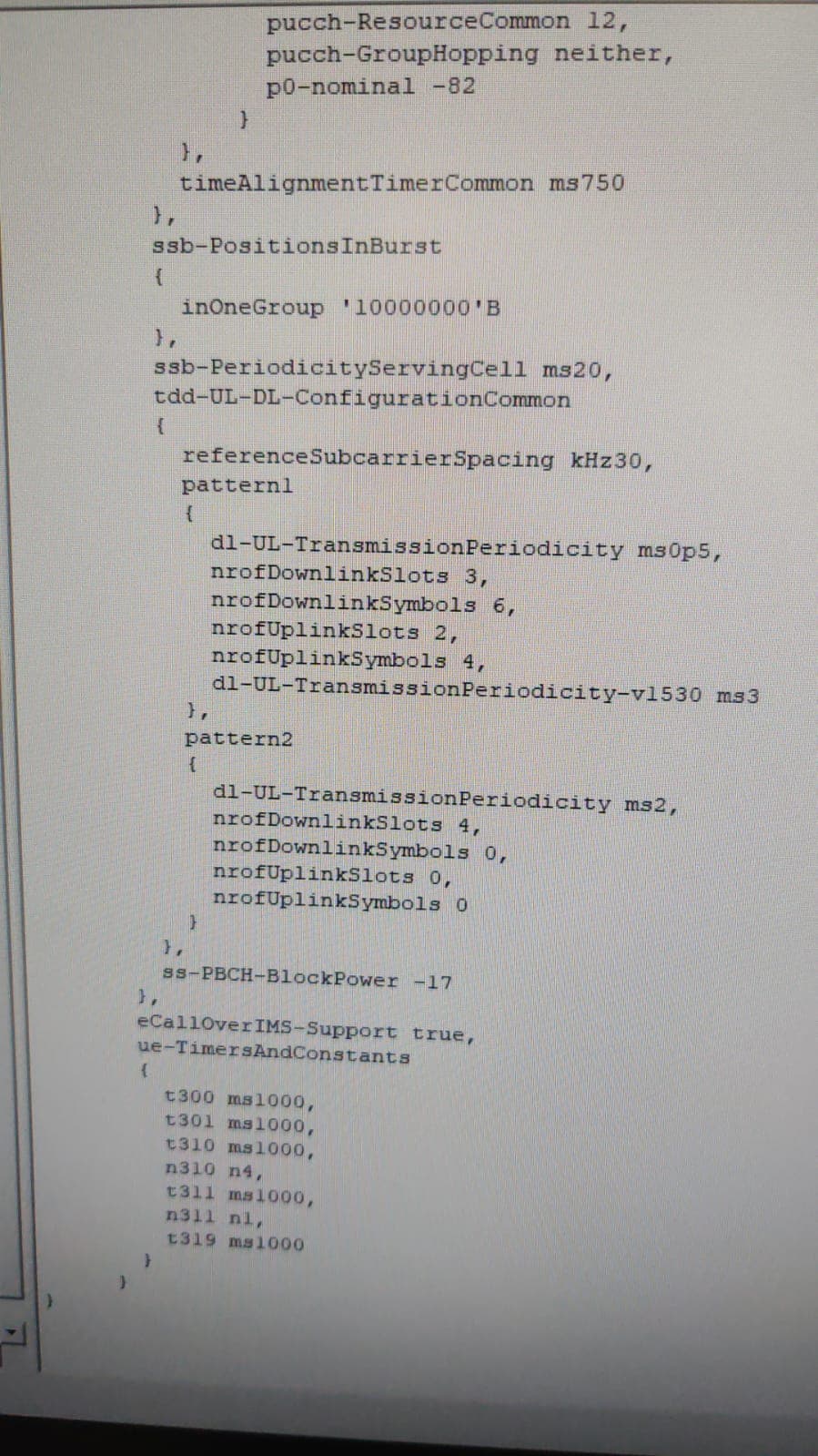

Check TDD DL UL configuration at the end in SIB1.
Here is the SIB1 message:
Yes, it’s DDDSUUDDDD.
Please, can you highlight on picture, where it is mentioned?
From pattern-1, you can get information about the starting slot, as highlighted. Here, we have 3 continuous downlink slots, followed by the number of symbols indicating a special slot. In this case, the first 6 symbols are for DL, the last 4 symbols are for UL, and the 4 symbols adjacent to the downlink symbols are for switching in the special slot. The next 2 slots are for UL.
Moving to pattern-2, you can see there are 4 consecutive slots for DL. By combining pattern-1 and pattern-2, you get a pattern like DDDSUUDDDD.
5G NR TDD Slot Configuration :point_down:
Check here, they have explained very well.
DDDSUUDDDD, right?

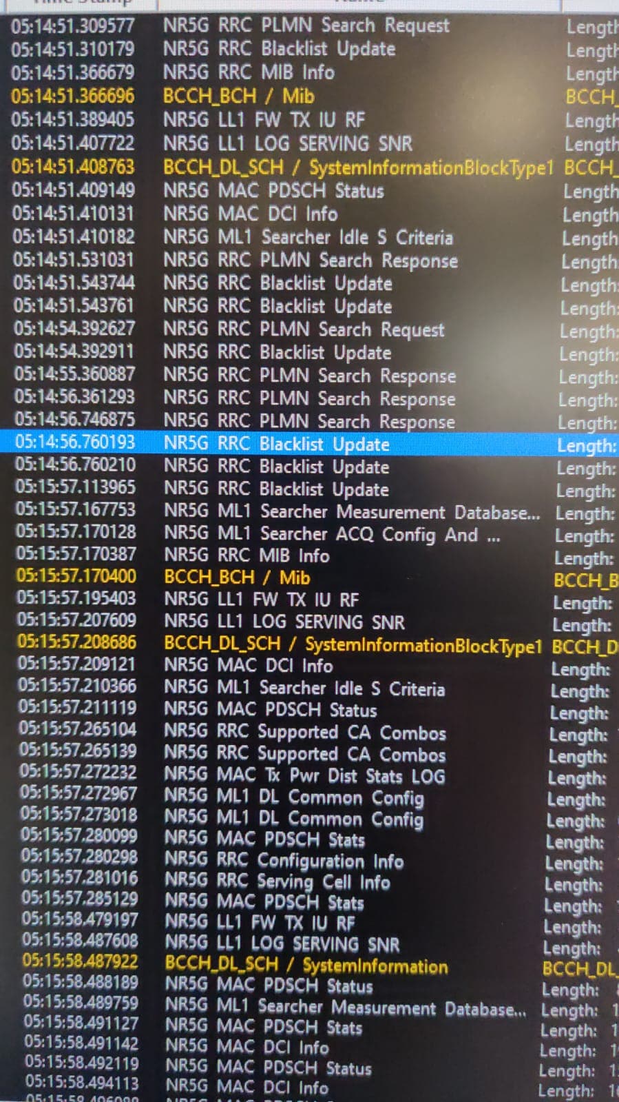

I’m curious about the NR5G RRC Blacklist update message.
Can anyone explain what it involves?
used to update the blacklist of forbidden cells or frequencies in a UE
Used to update the blacklist of forbidden cells or frequencies in a UE.
