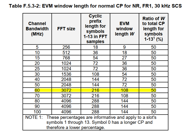

Hi Elisa,
FFT Size for 30 kHz SCS and 60 MHz bandwidth should be 3072 acording to table F.5.3-2 TS38.101-1 v15.
