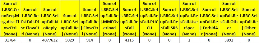

I am experiencing sudden degradation on LTE PS CSSR pending on high RRC failure.

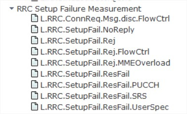

These High RRC Failures are on Signalling or Service?
I am new on Huawei. Any counter to categorized this on U2000?
Also there was huge traffic increase at the same time.
Check these counters in PRS:
Thank You.
Analysis for some impacted cluster:
Any optimization suggestion?
