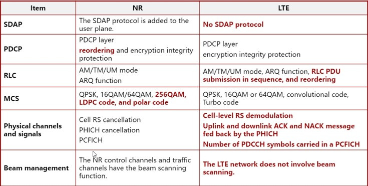

https://www.techplayon.com/5g-nr-radio-protocol-user-plane-whats-new-lte-5g-nr/
The answer is from techplayon.
