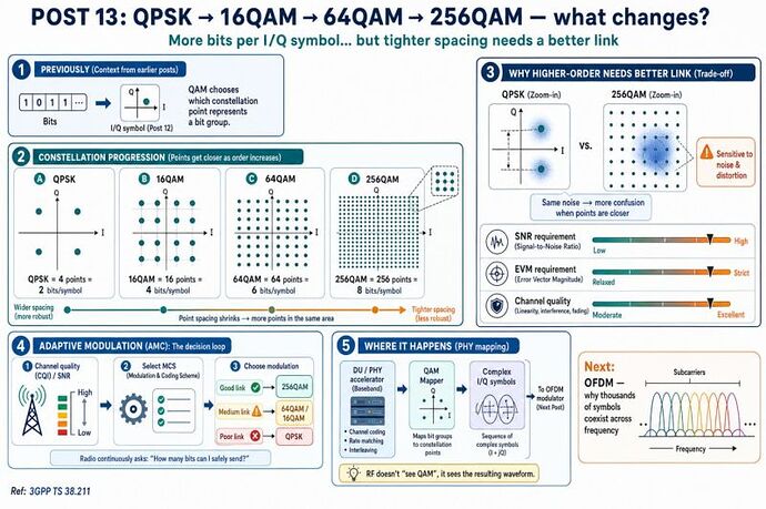

QPSK, 16QAM, 64QAM, 256QAM: what actually changes?
In Post 12 we said: bits get mapped to I/Q symbols (points on the complex plane).
Now the story continues:
Why does 5G use 256QAM?
Because it can pack more bits into each I/Q symbol.
The progression (bits per symbol) :chart_increasing:
QPSK β†’ 2 bits/symbol
16QAM β†’ 4 bits/symbol
64QAM β†’ 6 bits/symbol
256QAM β†’ 8 bits/symbol
More bits/symbol β‡’ potentially higher throughput with the same symbol rate.
The catch :warning:
Higher-order QAM packs more constellation points into the same I/Q plane.
So points get closer together β†’ noise, interference, and distortion have less room to β€œhide”.
That means higher-order modulation needs:
Better SNR
Better EVM (Tx/Rx quality)
Better channel conditions (less fading/interference)
The β€œadaptive” part (the real beauty) :counterclockwise_arrows_button:
The system doesn’t always transmit 256QAM.
It keeps asking:
β€œHow many bits can I safely fit into this channel right now?”
Good channel :white_check_mark: β†’ higher-order QAM
Bad channel :cross_mark: β†’ lower-order modulation (more robust)
Where does this live? :brain:
This is digital PHY (like we discussed in Post 12):
DU / PHY accelerator β†’ QAM mapper β†’ complex I/Q symbols
By the time it hits RF, the hardware just sees a waveform.
And next, that waveform gets organized across thousands of subcarriers…
Next: OFDM β€” what is it actually doing? :puzzle_piece:
Technical reference: 3GPP TS 38.211 defines NR modulation and OFDM baseband signal generation
