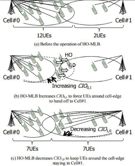

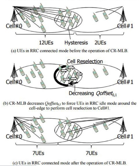

You can try with Reselection-MLB or HO-MLB.
Try decreasing Qoffset (FDD,TDD) for CR-MLB and increase CIO (FDD,TDD) for HO-MLB.
CR-MLB is preferred.
Operational principle of CR-MLB:
Operational principle of HO-MLB:
