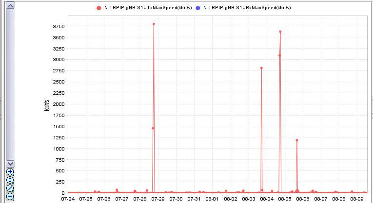

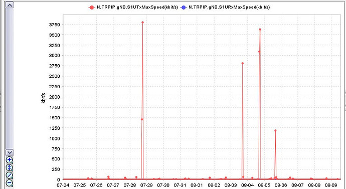

Sharing → I’ve found the problem: the S1-U interface suddenly up for some minutes.

Actually the issue was the S1-U interface suddenly was up for some minutes during the hour.
