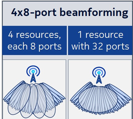

Thats why i think when u change SSB beam tilts it impacts CSI-RS and indirectly UE PMI reports
CQI and MCS indirectly.
I use tems discovery to analyze logs, but i will try to check , rank usage, cqi, mcs also, did a quick analysis and found DL throughput was better .
SSB beam tilts are different than antenna electrical tilt?
No, there is only 1 parameter called “etiltoffset”, this is for all. -3 +3 range in general.
Is this Nokia specific?
And how this offset works?
Let’s say my ret = 10 degree and offset is +2.
There is no ret this is MAA, radio and antenna is combined.
Only you can give mechanicel tilt.
etiltoffset = positive means additional electrical downtilt . minus electrical uptilt.
So in my understanding, when u change eitlt you change ssb beam tilt for sure and also PMI beams directions are changed.
But Nokia does not tell us this is happening like that.
