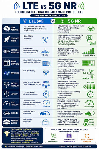

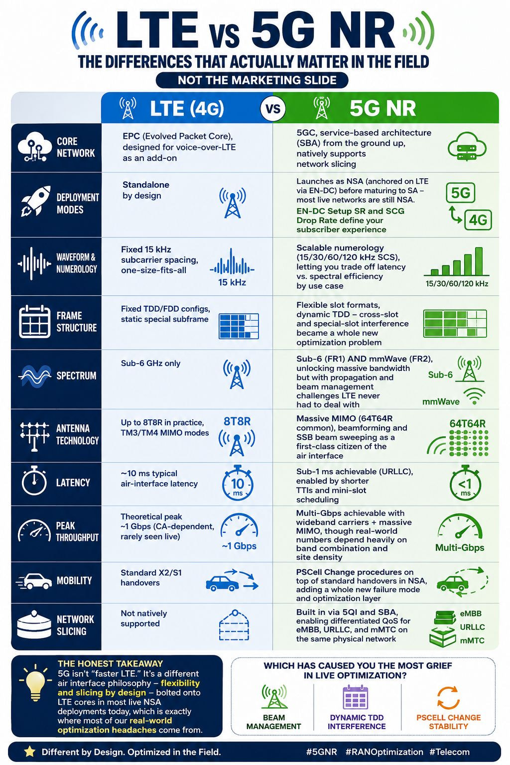

LTE vs 5G NR - the differences that actually matter in the field (not the marketing slide)
After 10+ years moving from 2G/3G into LTE and now living in 5G NR optimization daily, here’s the comparison I wish someone had given me on day one:
Core Network
LTE → EPC (Evolved Packet Core), designed for voice-over-LTE as an add-on
5G → 5GC, service-based architecture (SBA) from the ground up, natively supports network slicing
Deployment Modes
LTE → standalone by design
5G → launches as NSA (anchored on LTE via EN-DC) before maturing to SA — most live networks today are still NSA, which is why EN-DC Setup SR and SCG Drop Rate are the KPIs that actually define your subscriber experience
Waveform & Numerology
LTE → fixed 15 kHz subcarrier spacing, one-size-fits-all
5G → scalable numerology (15/30/60/120 kHz SCS), letting you trade off latency vs. spectral efficiency by use case
Frame Structure
LTE → fixed TDD/FDD configs, static special subframe
5G → flexible slot formats, dynamic TDD, which is exactly why cross-slot and special-slot interference became a whole new optimization problem
Spectrum
LTE → sub-6 GHz only
5G → sub-6 (FR1) AND mmWave (FR2), unlocking massive bandwidth but with propagation and beam management challenges LTE never had to deal with
Antenna Technology
LTE → up to 8T8R in practice, TM3/TM4 MIMO modes
5G → Massive MIMO (64T64R common), beamforming and SSB beam sweeping as a first-class citizen of the air interface — not an optional feature
Latency
LTE → ~10 ms typical air-interface latency
5G → sub-1 ms achievable (URLLC), enabled by shorter TTIs and mini-slot scheduling
Peak Throughput
LTE → theoretical peak ~1 Gbps (CA-dependent, rarely seen live)
5G → multi-Gbps achievable with wideband carriers + massive MIMO, though real-world numbers depend heavily on band combination and site density
Mobility
LTE → standard X2/S1 handovers
5G → PSCell Change procedures on top of standard handovers in NSA, adding a whole new failure mode and optimization layer
Network Slicing
LTE → not natively supported
5G → built in via 5QI and SBA, enabling differentiated QoS for eMBB, URLLC, and mMTC on the same physical network
The honest takeaway: 5G isn’t “faster LTE.” It’s a different air interface philosophy — flexibility and slicing by design — bolted onto LTE cores in most live NSA deployments today, which is exactly where most of our real-world optimization headaches come from.
Which of these differences has caused you the most grief in live optimization — beam management, dynamic TDD interference, or PSCell change stability?
