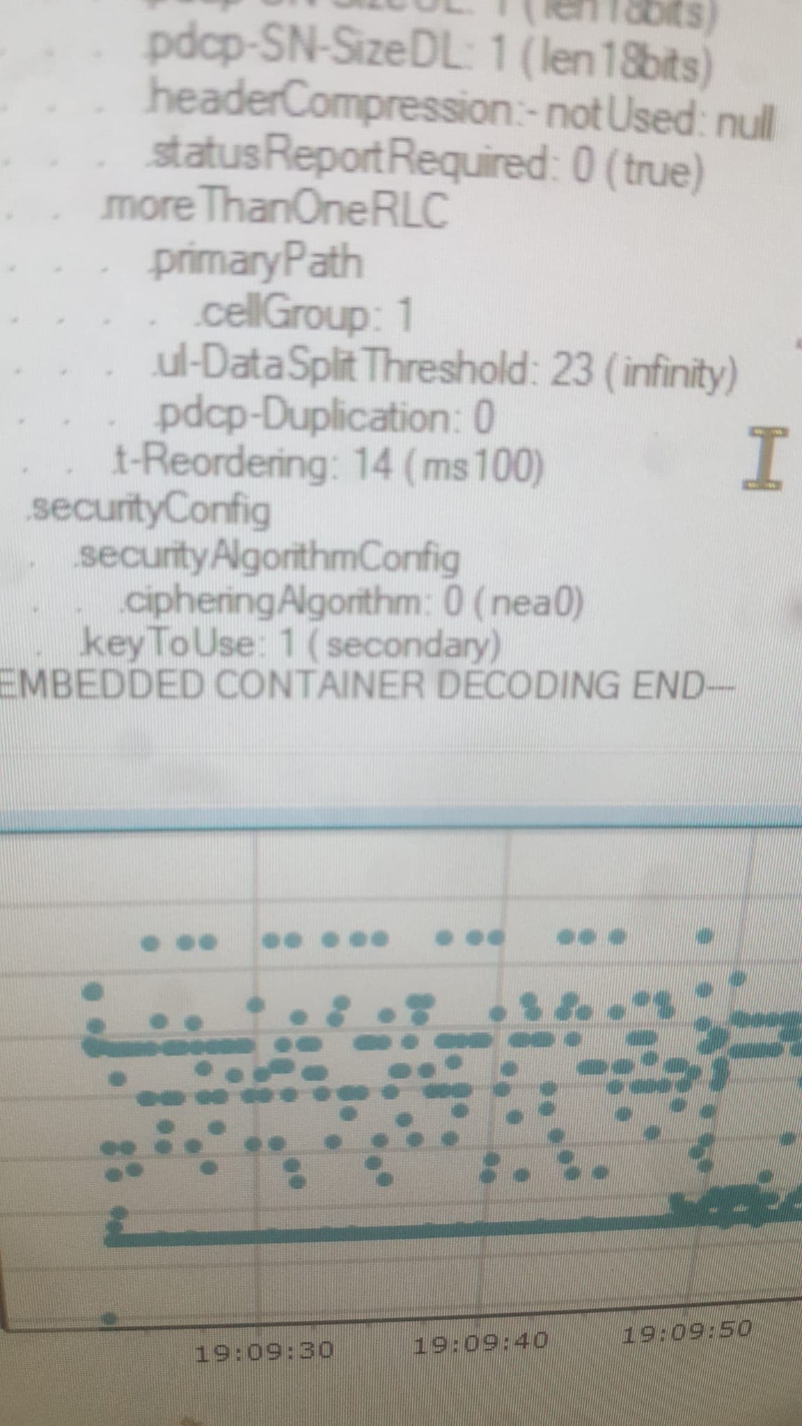

In NSA it depends of parameters, we have had this discussion before is about primary key. Just search on telecom hall for it.
Primary path.
Cellgroup 1 means SCG and Cellgroup 0 means MCG. This indicate the UL path used.
So cellgroup1 means that data is sent over SCG(NR) firts and then, over a specific threshold over MCG(LTE)
Cellgroup 0 means the other way around
For SA all goes over NR; only in MR-DC it goes LTE and NR.

This cell group 0, 1 tag there in some message alongwith Uplink Data or by counter, you mean?

It is in RRC reconfig to setup the NR at the end of message.

Yes, that message is clear but query is that while doing upload in NSA how we can check on which leg data flow ongoing.

If throughput is below uldatasplithreshold then it goes over cellgroup 1.
When is higher than uldatathreshold the difference goes over cellgroup 0.
So it can happen that data goes over both.
Ok. So user can check by counter or through nemo window if it open while doing drive test for state used for Uplink.
