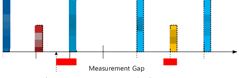

Do you mean measurements gap required for inter freq and inter rat measurement?
It’s required during VoNR or VoLTE call as well to keep mobility.
It’s for intra freq HO, but yes I know it’s mandatory to keep mobility.
But not sending measurement reports, is that possible by a UE?
I got a call in stable mode in which, for a while, the measurements stoped showing up on the trace.
Is it for 5G SA intra freq case m-gap config?
What issue you faced in call ongoing?
