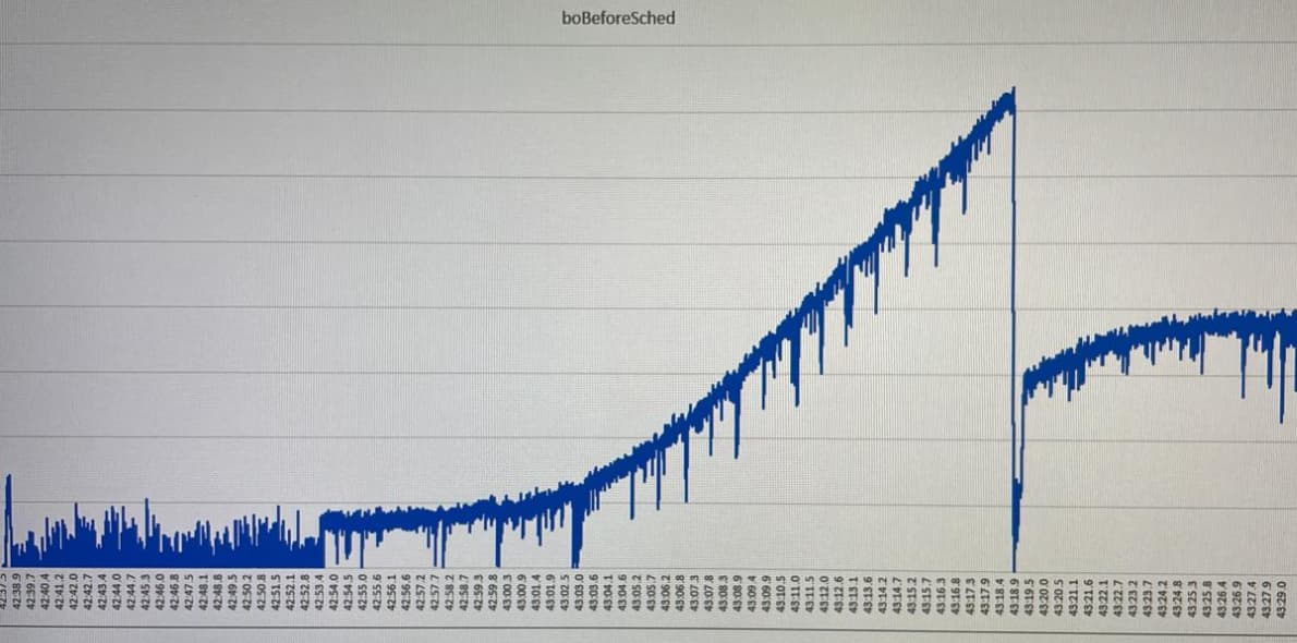

This is how the BO looks like in DU (eNB).
I agree there is not much BO initially.
BO = Buffer Occupancy.
So you see? Not enough data is coming from higher layers.
So on S1-U it does not come enough data for this UE.
Go check with core engineers from SGW.
UE is starviing from data from higher layers.

Yes there is PDCP flow control mechanism between CU and DU but the problem persists even without flow control mechanism.

Hi Pirtam
Did you manage to solve the issue ?
Hi @Mohamed_Abdelbasset ,
Yes, there were packet drops in CU side during the initial phase. CU Team fixed it.
