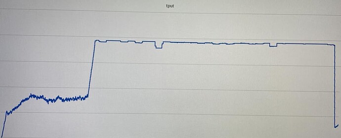

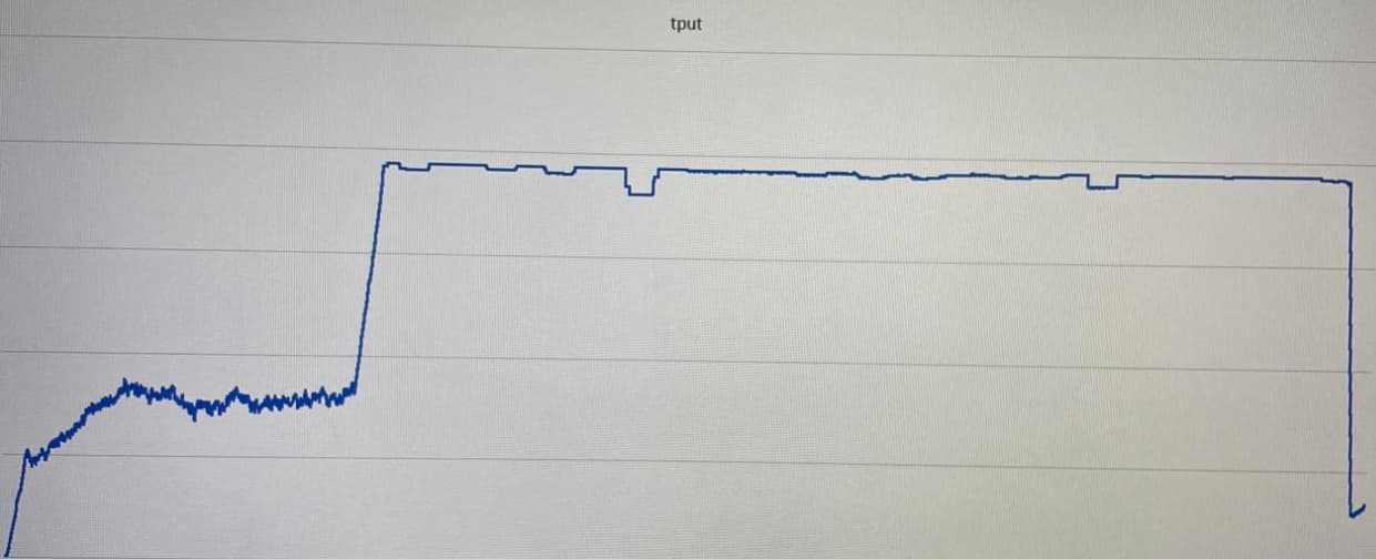

Sharing the Throughput graph for reference.
Here, one can see there is 16s delay while achieving peak Throughput.
But, worst case reported is 40s now.
