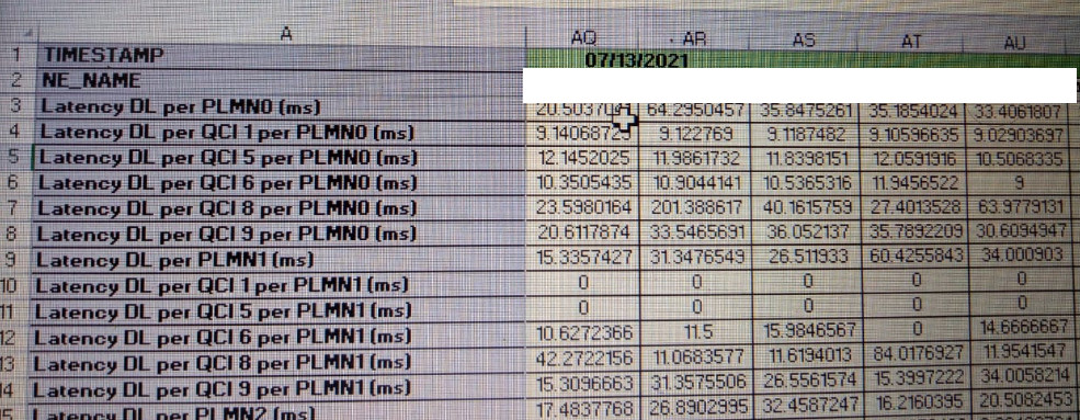

What should be Latency in VoLTE (ms) in KPI?
Is less than 10 msec ok?
Or it should be less than that.
It is impossible to be 10 msec.
60 ms seen. But vary from vendor to vendor.
Depends on what you mean by Latency.
I need to check formula. I too believe it’s not possible but, I have KPI sheet, after getting OSS i will see formula (as I too think it’s impossible).
Need to confirm formula as this is what I saw in KPI sheet.
But normally in QCI9 its up to 100 msec I believe.
VoLTE should be less as its real time.
But I think 25 to 30 msec can be possible.
In our case, Latency should be <= 40 ms for SCFT report to pass.
