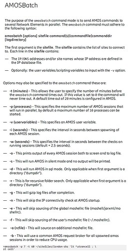

amosbatch is a tool to execute mos script on multiple nodes, it is preinstalled on ENM
put yours commands in a .mos file and execute with mobatch.
Can anyone provide the commands or the process to run an MO batch in Ericsson?
amosbatch -p 30 -t 30 -g /path_for_site_list/site_list.txt /path_for_commands/commands_to_run.txt /home/path_to_save_results
