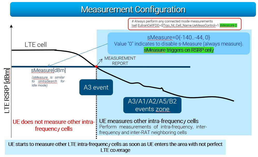

Smeasure is for all intra-inter.
In Nokia threshold1 for a3 start measure and threshold2a, hysthreshold2a are used.
So when serving RSRP - hys threshhodl2a > threshold2a then EVENT A1 is to be sent, stopping measurements.

This is the general description for Ericsson 4G in Connected Mode:

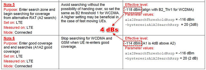

Between a2 and a1 stop meas how many db do you set?
4 dBs effective level, and 40ms (quick) for timetotrigger for A2 and 640ms (slow) for timetotrigger for A1 events → this is, ensuring good levels before to stop measurements.
For Ericsson case, there is the option to configure A1 and A2 independently, but generally it’s used the feature: Mobility Control at Poor Coverage to manage this kind of situations, and this feature only gives the possibility to set one threshold for A1 and A2, which is adding or subtracting to the current signal level according to the signal level fluctuation and the A1 or A2 events occurrence (see image, which show example levels, not the same I use)
In general terms, I think this option is better (and less risky) than setting independently A1 and A2.
I agree 4 dB or more, but timetotrigger I generally set the same for both a1 and a2.
