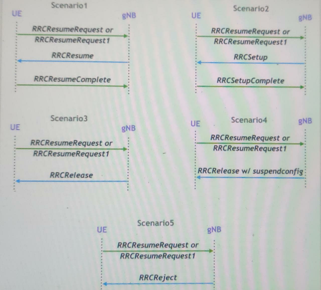

I’ve read all this conversation (>40 replies), and now i would like to ask exact steps the way UE goes to idle.
Is it like gNB will send direct rrc-release to UE (let’s say which is on inactive state) upon data inactivity around 1500s?
Or during inactivity UE sends RRC resume request & then gNB respond with RRC release or RRC reject?
So on RRC inactive state any of the 5 senario can happen looks like if S1 executes it will go to Connected if S4 executes it will be on inactive only.
If S3 triggered then only ue can go to idle , now seems like this scenario can happen only after 1500s (correct me if i wrong here.

So how UE move from RRC inactive to RRC idle - Is it via RRC resume or directly?
Resume is when UE moves from RRC_INACTIVE to RRC_CONNECTED.
RRC_INACTIVE to RRC_IDLE, only reason I could think of is abnormal release.

There is one possibility…expiry of t380 and also if gNB has some configured maximum inactivity time for an UE.
In the both the cases, gNB can send UE from RRC_Inactive to RRC_IDLE.

In RRC Inactive state , If UE have UL data to send, it will initiate RRC resume request.
If UE have DL data, RAN paging will happen.
If there is no DL/UL data for UE, it will keep doing periodic RNA update every T380.
If UE spent 1500 s (vendor specific) without any DL/UL data, gNB will release UE context and when UE performs next RNA update gNB will send RRC release to UE.
If UE initiate any UL data while RRC inactive and gNB has already released UE context, then gNB will initiate RRC setup in response to RRC resume by UE. This is to setup UE context again.

So it’s like without RRC resume as required for RNA update UE can’t move from RRC inactive to RRC idle.
It’s like RRC inactive → RRC resume for RNA update → RRC release
Correct!
I’m considering like RRC inactive → RRC idle can be possible without RRC resume in between.
It’s not possible directly.
Because RRC Release has to be communicated to UE by gNB.
UE cannot do RRC release autonomously.
